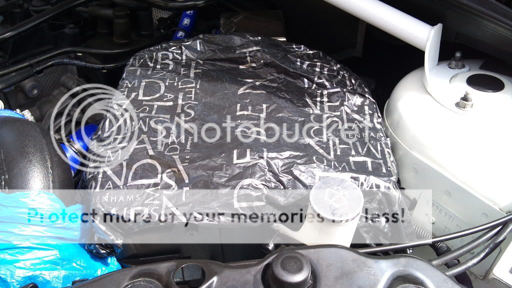

Bag up your main block ensuring all spark plugs are well covered and secure with some masking tape.
Step 7:

Once happy that all vulnerable areas are masked and bagged up securely and you've GUNK'd all areas with high dirt/dust/grime build up, jet wash over the top of the engine bay covering the whole bay evenly. (NOTE: - Hold the lance a good few feet away to ensure you don't blow off any masking tape or bags and to prevent direct pressure of water into any vulnerable components. ALSO, quickly sweep over the engine 3-4 times only. This helps to prevent large volumes of water in the bay).
Step 10:
Once finished with the jet wash lance, it's now time to remove all masking tape and bags from the engine bay. (NOTE: - Make sure you take a few moments to carefully view everywhere so that you don't miss anything and be careful not to snag or damage any wires in the process).
