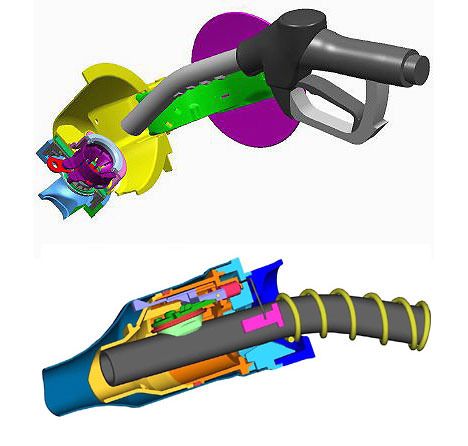

Just joined the forum today and was wondering if anyone can advise me on the easy fuel system that's fitted to the Fiesta ST2 (2014) model.
I'm not sure what its supposed to look like at the top of the filling pipe but think there might be a bit missing. There is also a plastic bit with rubber seal around the edge floating about at the top of the filling pipe which is too big to remove from the pipe and has to be moved to the side just to get the petrol pump in.
Have uploaded pictures of the problem.

Absolutely this should be a warrantied item. ITs not a wear part, and not user serviceable so they cant have you for that. They might argue that its user inflicted damage but i reckon you'd have a case that if the "easy fuel" system can be damaged by someone putting a fuel nozzle into it, then its not fit for purpose...
as far as bits missing, there's a catch and flap assy, but it looks to me like the whole lot has pushed in to the filler. Potentially there's a comfae bit still kicking about somewhere so I'd be asking ford to scope the tank unless they can demonstrate they've recovered or accounted for all the parts.

Was looking at this on the internet and the bottom picture from your post looks like the system I've got with the flap opening up when inserting the petrol nozzle..,few ! choosing my words carefully here as don't want the post to be sent for censoring ! hehe.
The flap looks as though it has broken away from what I can describe is a small hinge type piece of plastic that can be moved backwards and forwards and appears to be attached to the top rim of the fuel pipe.
